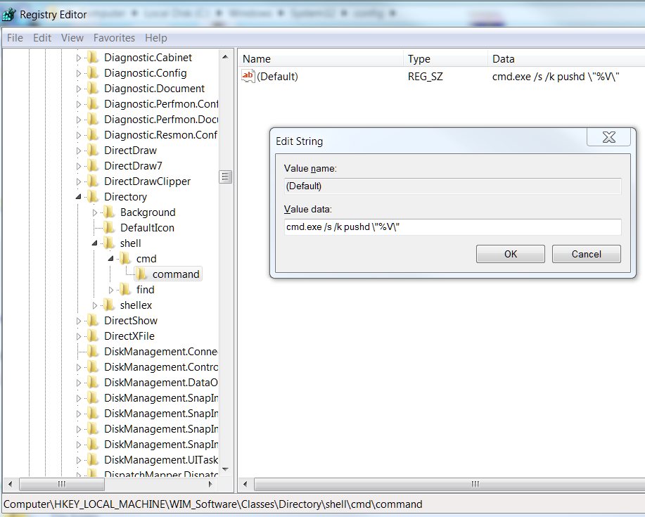

Hi Legolash2o,
Thanks for your excellent application. I use it to build my own Win7 integrating:
All x86 + All x64 (Except K, N, KN edition but I included Enterprise Edition) + US, FR, KOR, ZH and ES version + SP1 and all post update until June 2011. Flash/SilverLight/7-Zip with some windows tweaks and all official theme
I found a little bug in the AIO Tweaks part so I would like to inform you...
In the Tweaks part, Context-Menu
"Add Open CMD here" to Folder Context-Menu
I checked this option for all my Win7 version
I have just tried to install a Windows and there is an issue with the registry in
HKEY_CLASSES_ROOT\Directory\shell\cmd
You should delete Extended and Icon entries which don't work. I don't find any difference by adding "Extended" and "Icon" doesn't really put the CMD icon but a Windows icon, so it is better to remove it too.
HKEY_CLASSES_ROOT\Directory\shell\cmd\command
The main issue is on this key. You put exactly:
cmd.exe /s /k pushd \"%V\"
So when i tried the context-menu, it worked but i have a warning message at the CMD opening which saying that the current path could not be find...
To fix this issue i use WIM Registry Editor and i am currently removing one by one the registry entry in:
HKLM\Winm_Software\Classes\Directory\shell\cmd\command
by removing "\" which is useless.
Then everything works fine and the cmd.exe could find the current path from the context-menu
(... I don't tried with Elevated CMD prompt but you should also checked it)
So the key should be like
cmd.exe /s /k pushd "%V"
