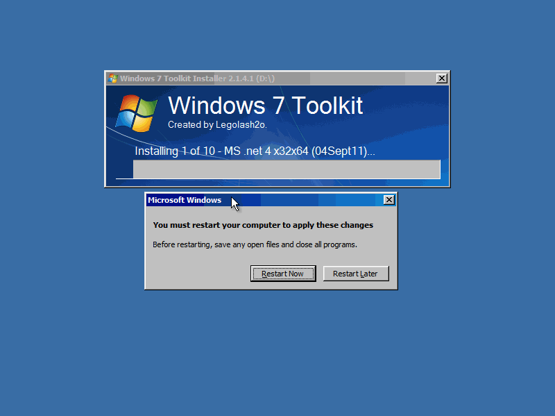

Well ... it took me a couple of round of integrations. I tried removing the "setupcomplete.cmd" and even tried integration a bit differently (IE9 first instead of last). There appears to be an update that gets integrated and wants to change something near the end of the installation. Attached is a screen shot. This screen appears right before the W7T run silent installers section.
Edit: Added a better screen shot of the "condition".
Whoever made that silent installer for .NET 4 should of added the /norestart or equivalent switch.
@crashfly - Can you verify whether it is the .NET 4 installer that is the culprit? I don't think it is, but if it is then I'll help get the word to Troubada/Trinket so he can resolve the issue, once you have verified the need.
Cheers and Regards
I already let them know it was not the .net 4 installer. I only posted that image as it appears as the silent installers are starting. I cannot tell if the problem is from a driver installation (it may be that), or from an update. Unlike Windows XP, Windows 7 does not have a "clear" explanation of the install process (in other words, at time period xx, such and such happens).
