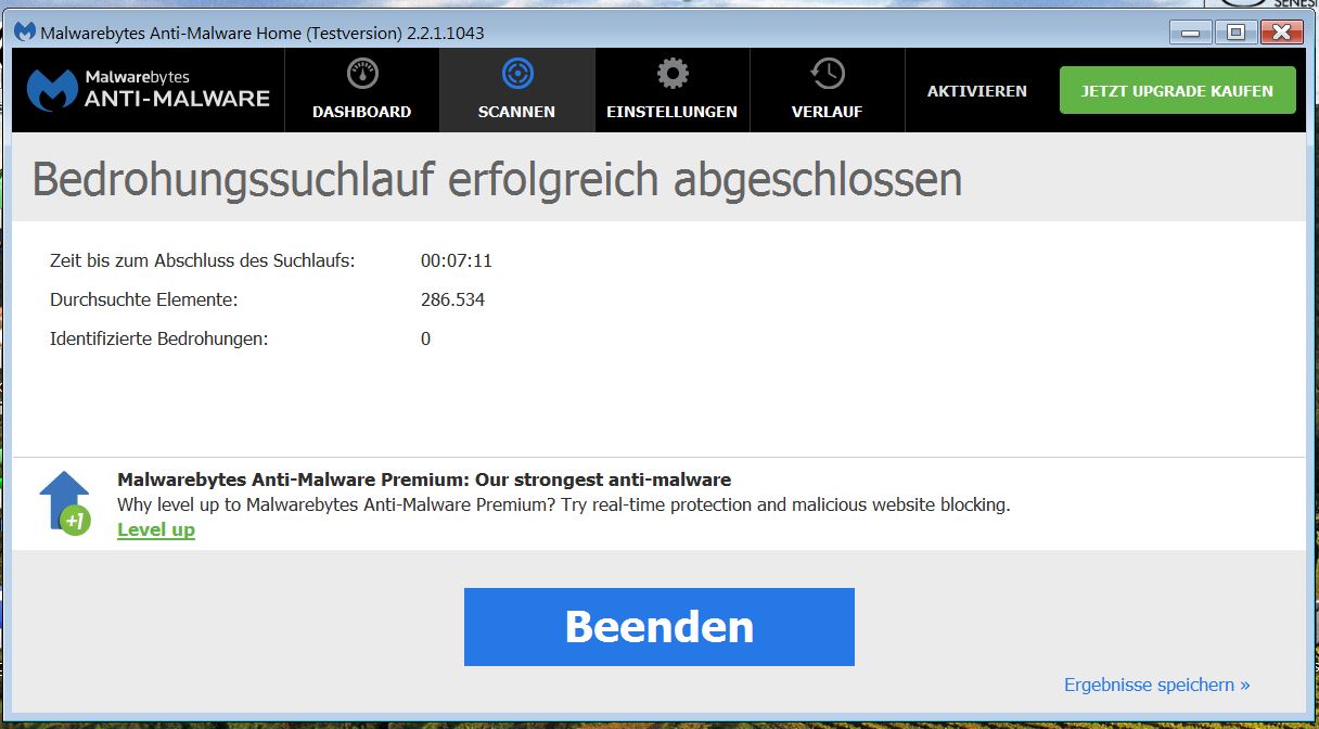

40 minutes ago, Thiersee said:
I don't know, what you've installed, here my MBAM-test
VM with Win7 Prof x64, German, WUD Convenience Rollup, WTK, my 55 standard-programs, NFW 4.61
