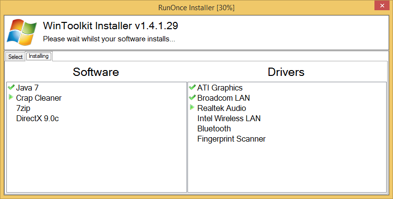

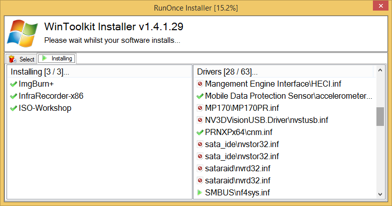

Here's what I've got so far:
Selection Screen
post-10183-0-92137200-1388936934_thumb.p
If you decide to allow users to select what software they want, they will see a screen like this. Once they have selected what they want, they will go to the queue.
Installation
post-10183-0-51794700-1388936944_thumb.p
Whilst the first screen is open, the RunOnce is installing drivers and software which get installed no matter what. That way software is being installed whilst you select.
Thoughts?

Also if you have allowed a user to select programs and the computer has been idle for 10 minutes, it will close the RunOnce after drivers and automated software is installed.
#Lets you specify the configuration of the installers#InstallDir is where your apps are located#DriverDir is which directories to scan for inf files#Reboot makes RunOnce reboot Windows after completion#ShowBrowse will show folder browse dialog if no source is detection[Config]INSTALLDIR=E:\WinToolkit_Apps2INSTALLDIR=E:\WinToolkit_Apps3INSTALLDIR=WinToolkit_AppsINSTALLDIR=Sources\AppsDRIVERDIR=Sources\Drivers2DRIVERDIR=E:\Sources\DriversREBOOT=FALSESHOWBROWSE=TRUE#Things which will always get installed. Anything after * is a switch i.e. /S /Q /Silent[Automatic]ISO-Workshop=%DVD%:\WinToolkit_Apps\ISO-Workshop2\ISO-Workshop.exe*/S#User will be asked to choose which of the following apps to install.[Manual]
You can now have a install.ini file within your sources folder. :P When you have InstallDir added multiple times, it will scan all locations for the exe so you can have files scattered if need be.
If a location doesn't have a drive specified it will scan the roots of all driver until a match is found. Drivers install pretty fast too and only install the needed ones :P
Also, if manuals are listed and the user hasn't moved the mouse, etc.. after 10 minutes, it will continue with the windows installation with just drivers/automatics installed.
