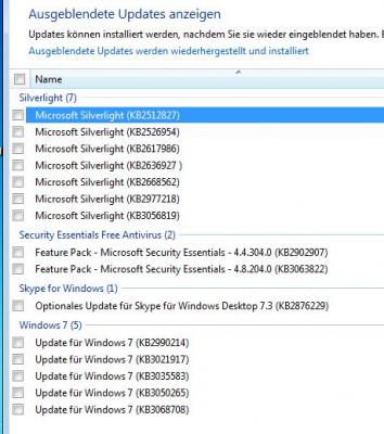

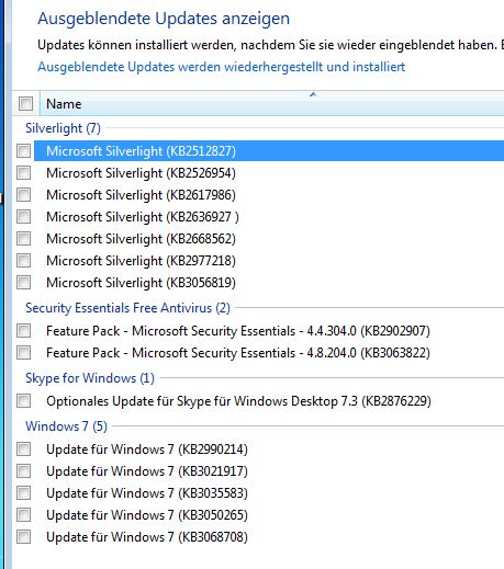

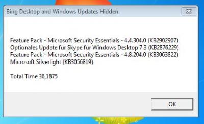

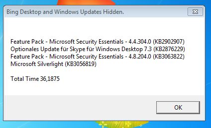

Hide KB's .vbs worked in setupcomplete, took 5 1/2 minutes though but did not hide 2 MSE's, Skype & all the Silverlights, it only hid the 21 "regular" KB's.
If you put tthe KBs of MSE, Skype & Silverlight as KBXXXXXXX not as name it works and hides those KBs.
A special case is Silverlight:
if you hide only KB3056819, this will be hidden, but WU requests for 6 older Silverlight KBs!
They are:
KB2977219
KB2636827
KB2668562
KB2617986
KB2512827
KB2526954
Just tested in a VM, x86 HP.
You can see: no optional-updates anymore!
Have a nice week-end, Thiersee

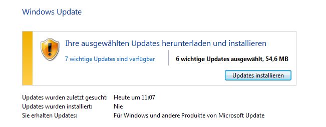

I still getting KB976932 as well, even with KB2533552 installed via setupcomplete.cmd   /win7 x64 pro
Even if you install it after the win-installation has finished?
Which is the size of requested SP1 in WU?
Thiersee
Thiersee
It's 9.1MB, same size as before. I'll run some tests with a new list, once I get back home tomorrow, from the trip.
I don't know at which point setupcomplete.cmd has effect (I don't use it), but try to install KB2533552 when the installlation has finished.
