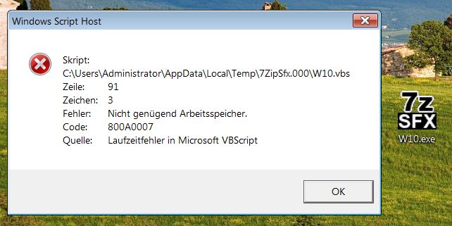

Hi everybody,
I need some help for two issues I have since last patch-day; they regard only Win7 HP x86.
1) After installing Win7 I start WPI and the first program is W10.exe: after a couple of minutes W10.exe stops running and says "Runtime error in vbs, error-nr. 800A0007"; I quit the error with OK and WPI continues with the other programs. At the end the W10-related KBs are not moved to the section for excluded KBs.
Unbenannt.JPG.4a531ef45f3b2700f6481933f4
2) After WPI has finished and the machine rebooted I start a search in WU: no chance, I got the error 8007000E; if I re-register wups2.dll  the search works: I found the hint in internet. To re-register:
net stop wuauserv
regsvr32 /s %windir%\system32\wups2.dll
net start wuauserv
I tested with:
a. UL 09-09-2016: update, RDP, IE11 and the first three additional updates
b. VirtualBox (x86-VM)
c. the same INI I've used since months! Those INIs have been working until january.
With Win7-x64 HomePremium and Professional (italian or german) absolutely no problems!
Do somebody know, where can I begin to search, what is different or what I made wrong?
Thanks in advance for your hints or help., Thiersee
Edited by Thiersee
Hello Thiersee,
I encountered the same problem after upgrading to last Virtualbox version and x86 VM. I have an other problem, display shows an old Win95 aspect (no aerobasic style). Since I deleted previous version I can't do an other test. All is OK with new x64 VM.
If W10 is the guilty (perhaps too much updates for x86 Virtual RAM), using previous version or deleting 2 new updates in the script could solve the bug.
Edited by rhahgleuhargh
3 hours ago, rhahgleuhargh said:
Hello Thiersee,
VirtualBox (RAM 4GB, 2 cores used):
I use version 4.3.12; with the actual version 5.x.x I get an error, if I try to start a VM.
To much W10-updates? Could be a possibility; I will try it tomorrow.
Thiersee
Thiersee
Ok, so it's not due to newer version of VirtualBox (the error with versions 5.x occurs when you patched uxtheme.dll).
Have someone tested W10 script in a real x86 installation ? if there are too much updates for x86 memory, I'll need to split it in 2 parts, not sure if it will work. But in this case, why does it work without any problem in x64 ?
