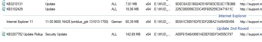

42 minutes ago, rhahgleuhargh said:
@Thiersee
thx for the report. If next Rollup pack is recognized as second round update I won't rename it in next UL release (and probably delete IE11 category ?).
What about the .net FW351 rollup ?
Is under "Updates"
1 hour ago, Thiersee said:
Is under "Updates"
I have to "un" ditto my ditto. I just ran WTK 1.5.4.8 (I misunderstood before) but now see thiersee's post and I do not get an "update 2nd round" category. My kb3207752 update rollup is in the internet explorer category right below Internet explorer 11. So I do not see any difference from WTK 1.5.4.7. fyi...
regards...
regards...
Probably is your file still named IE11-Windows6.1-KB3207752-x64.msu (from the UL) and not simply Windows6.1-KB3207752-x64.msu....
Edited by Thiersee
oops my bad. yes I forgot to rename it. thanks thiersee (again).
