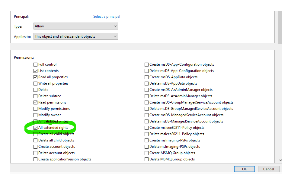

If for whatever reason above command won’t work, you can delegate control to AD group or individual user to a specified OU and add All extended rights permission for This object and all descendant objects as seen in the screenshot below.
