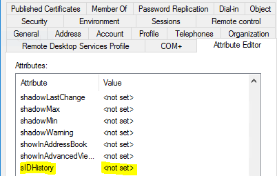

You can check if the sIDHistory was deleted by refreshing the container in which the user account is located.
Before: (part of the sIDHistory was removed due to security purposes)
After:
