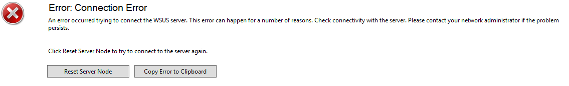

During the regular updates approval on WSUS, I have run into a WSUS error. We are using Windows Server 2012 R2 server with WSUS 3.0 environment.
When I have tried to open the WSUS console I have received the following error message:
Error: Connection Error
An error occurred trying to connect the WSUS server. This error can happen for a number of reasons. Check connectivity with the server. Please contact your network administrator if the problem persists.
Click reset Server Node to try to connect to the server again.
wsus error
I have also noticed that the WSUS service wasn’t started. Event viewer showed me Event ID: 7053 error.

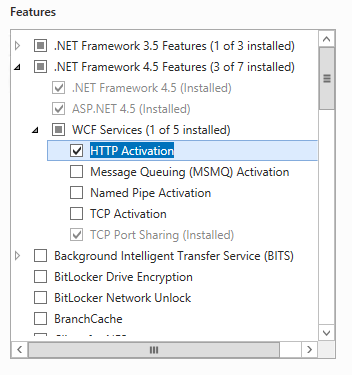

Once you get the “successfully completed” message open the Server Manager and install the following feature:
.NET Framework 4.5 Features
WCF Services
HTTP Activation
wsus error
This will additionally install the Process Model of Windows Process Activation Service.
wsus error
After successful installation, please restart the WSUS service and you should be able to open your WSUS console normally.
