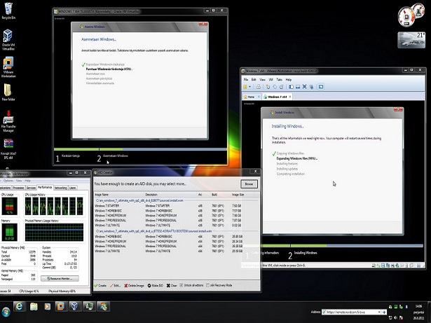

Print screen please, not of the error but of the list before you click start.
Indicates that has the same name already. I've changed the names but did not help
Edited by TH-TECH
I would still like a printscreen please of the list before you click 'Start'/'Create'....
Working Fine for version .25 !!

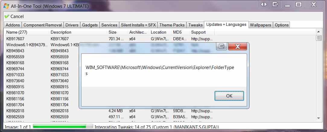

You may have fixed this problem in version 27, as this error I got was in version 24. It is included below. If the error comes back, I will let you know.
post-11322-0-59144300-1314362319_thumb.j
Edited by crashfly
That is not an error, it's just a message box i forgot to remove.
