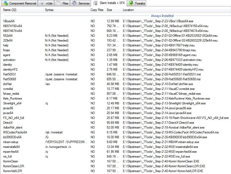

Rica... I think your right... I just looked at the list and failures and I think the MSU's that WinToolKIt handled all failed but the installers I or others created ran
Just out of curiosity: those installers made silent by switches through WinToolkit... were they installed, or skipped? Thanks :)
@compstuff Think you've got me wrong - I didn't mean those installers that were made silent (with let's say SFXMaker) prior to adding them to WinToolkit, I meant those that needed a silent switch / syntax, and you have to introduce that switch manually in WinToolkit, as Lego mentioned at no. 3. For me, the answers are:
1. YES;
2. NO;
3. Don't know, don't have any. But compstuff does, as I see from that list posted (mscodecpack, mbam etc). Curious for the answer :)
LE: For oguz the answer to 3 is NO, as I can see here.

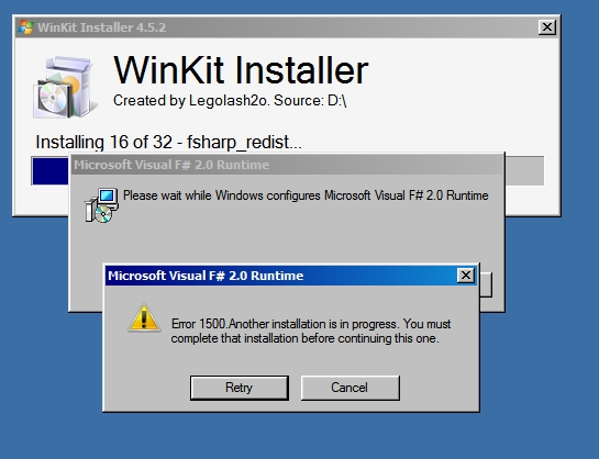

I thought I attached this last night but I was so tired I skipped it... it is actually the first error I see during the install timing and I do not have this with v10... every item in my list runs perfectly in v10
