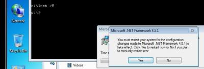

I was gonna ask you guys what switches you add to make it silent. I have tried these below and  it didn't work.
/ai /norestart
/s /norestart
...then I tried with no switches and I got the same error.
Let me guess, its a repack by you...the installer name is all wrong in YOUR repack
Next time give all the facts, dont come saying there is a problem with MY installer when its clearly NOT mine you are using
Nope, I haven't touch an .exe, I just dropped it in "scripts" folder along with setupcomplete.cmd  and added this lane:
START /WAIT %windir%\Setup\Scripts\dotNetFx451_Full_LDR_x86_x64_Slim.exe
then I tried those switches above.
I am just trying figure it out what went wrong, that's all. I didn't happen before.
Edit: I see now you are the one adding /norestart...compare the MD5
Anyway, added proper tools to repack for those interested, you will find them on the first post
I had that error with the first installer I made with 4.5.1 Preview, you could have still had that one
BTW did a refresh of the "intl" installer, nothing major (no need to reinstall your LP if you have already installed it.)
I did fresh install again...
Really strange. I downloaded again, used the tools provided by you in  first post to  repack and make it silent and all went as smooth as butter.
Thanks and sorry for the confusion.
