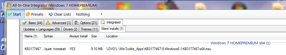

April 22, 20178 yr Hi Ron, I had today the time to test an english ISO. I built Win7 HomePremium x64 in two steps: Step 1: I integrated only the last WUD-UL (Convenience Rollup with RDP), under "Silent-Installers" only KB3177467, under "Options" your Options; no tweaks, no programs, NOTHING other! Step 2: I integrated your tweaks (NO reg-files!), under "Silent Installers" just a Desktop-Icon to launch WPI. After installing Windows 7 HP (VirtualBox) and rebooting I launched WPI and installed Telemetry.exe, NET-FW 4.6.2, Flash_ax_25.0.0.148 (generated with Flash_Silent_install_Maker_3.8 from @mooms) and my RAR-Updates-SFX-archive with KB2685811, KB2685813, KB3046269, KB2603229. Result: NO issues, NO strange requests from WU, nothing else; WU requests only Silverlight, Defender-Definitions, Security Essential, Skype, Malware Removal Tool and the preview for the netx rollup (optional!). I append some pictures to show that. P.S.: please, check your private message in the next 20 minutes Edited April 22, 20178 yr by Thiersee
