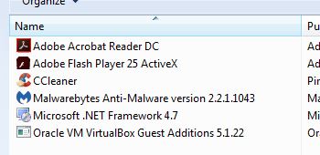

btw, the iso was created successfully and nfw 4.7 is listed in programs and features. its size is 1 gb. In WU I have 5 updates to be installed. strangely WU has kb2603229 and kb3046269 listed even though they were listed in my silents. The other 3 updates are 3 that are expected, 30008923 and mrt, defender. I just installed them and all 5 got installed successfully so they were all needed. I just did another check and now WU wants kb3177467 installed. What happened is those 3 updates did not get installed from silent, when placing kb4019990 after them and before kb2685811, kb2685813. to repeat my silent list was in this sequence:
2603229, 3177467, 3046269, 4019990, 2685811, 2685813.

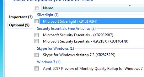

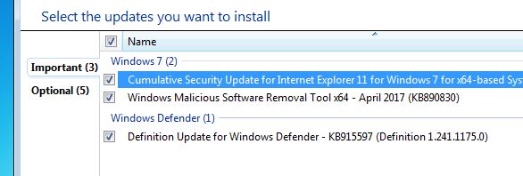

after the last reboot WU requests (pictures):
7 hours ago, Thiersee said:
I can't confirm, I get only KB3008923.
If you hide 3008923, 3003057 will be offered... hide that one and 2987107 will be offered.
It just an incomplete job in expiring old superseded update, in order to further reduce Windows Update scanning load
they expired most of IE11 cumulative updates (around 14 updates)
however, the supersedence chain for KB3008923 is now broken, the update that supersede it is expired
therefore and by metadata rules, KB3008923 is not superseded now
they did this exact same incomplete job for Windows 8.1 just before 2 or 3 months
the mistake did not last long, and they fixed it and competed the “expring” job within a month
bottom line, just ignore KB3008923 for now until they fix the issue and expire it
even if it get installed by WU, it have no affect at all on IE or system, because it’s completely superseded and won’t be active
https://www.askwoody.com/forums/topic/december-2014-ie-patch-kb-3008923-is-back/#post-113014
