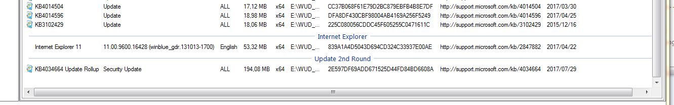

 I have another question, everyone. I have finally solved my problem with IE11 bombing on me and have been watching the integration of my updates very closely. After IE11 gets integrated then the proper monthly rollup (for august kb4034664) gets integrated. The bottom of the WTK screen lets us know what's happening with these integrations. Immediately following the monthly rollup WTK says "now integrating 4 unknown issues". It then integrates 2533552, 2603229, 3046269 and 3177467.
My question is this. I do not have 2533552 anywhere in my installation and 2603229, 3046269, 3177467 are in my silent list. why is 2533552 getting integrated and why are the 3 other updates needed in the silent list?
regards...

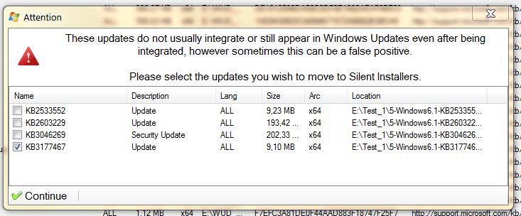

@pennsylvaniaron
If you use a preset, where this KBs are still there as "Known issues", they will be integrated, even if you put them under SFX too!

3) Without using a preset import in WTK IE11 and all the KBs from that folder; you get this mask, check all and continueRon_WUD_SFX_1.JPG.aeffc5e124e2e36314a3b0721af3e256.JPG
4) Move KB2685811 & 13 to the "Silent Installers", the result is this one; do not put them manually under "Silent Installers" otherwise you have them twice!

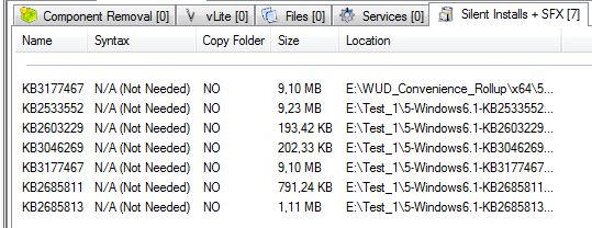

thiersee thx for the reply. I do follow exactly what you have shown. in options I DO have the box checked to move unknown issues to silents. 2533552 is 1 of the 4 on that mask list. after I move 2533552 to silents I then REMOVE it as per the tutorial (my choice). you see, using the preset was giving me that problem with IE11 failing. I was just leaving those 5 kb's in the silent list month after month and when the mask came up I did not check the kbs to be moved (because they were in silents already. Didn't make sense.) Doing it that way IE11 fails (at least for me, possibly a bug??)
So I changed my method. I still use the prior months preset but now my first step is to go into silents and remove the 5 kb's. Then I load all the new ul's updates and when I get the mask for the 4 unknown issues. I check them all to go into silents list. I then go to silents, remove 2533552, go back to updates, rt click on 2685811, 13 and move them to silents. I then position the 5 kb's in silents at the top before ccleaner, mbam, nfw etc. This method works flawlessly with IE11 getting properly integrated.
lastly, again, if those 4 kb's get integrated after the monthly rollup, why do we need them in the silent section? I will test now removing them from silents.
regards....
Edited by pennsylvaniaron
wrong kb #
Just did another test and confirmed that 2533552, 2603229, 3046269 and 3177467 not needed in silent list. My only kb's in silent list are 2685811 and 2685813.
after installing this iso into VM WU only asks for MRT and defender. I installed those updates and did manual check again and NO important updates. only 2 optional, 4032113 and 3102429. deep clean uninstalls 2534111.
regards...
