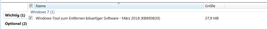

After two days of intensive testing I got the explanation!
With the actual version of MSE-definition-updates the AV.reg (QualityCompat) is not installed anymore, at least since 6th of march (my 2nd oldest definition update for MSE)!
1) Fresh install with February UL (but with updated MSE!):
no requests from WU for newer update, only 4 old patches for windows and 2 for FW, look at picture 1.

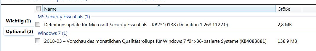

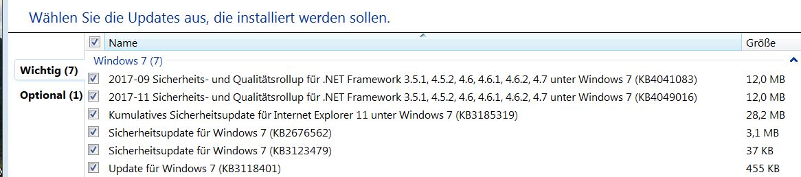

2) Manually inserted QualityCompat-REG, restart (not really necessary), new search:
ONLY the actual preview kb4088881, MRT and eventually MSE definition updates, look at picture 2 & 3; deleting reg-key, same requests like point 1).
3) Fresh install with March UL, old MSE (up to 6th of March):
ONLY the actual preview kb4088881, MRT and eventually MSE definition updates, look at picture 2 & 3.
4) I decided to integrate the QualityCompat-Key per Tweak in WTK, fresh install with today's definition updates for MSE:
ONLY the actual preview kb4088881, MRT and eventually MSE definition updates, look at picture 2 & 3; again, deleting the key from registry: same requests like point 1).
So, let us wait for what MS will do in the April -rollup.....; anyway the reg-key is now necessary for new installs with an updated MSE.
