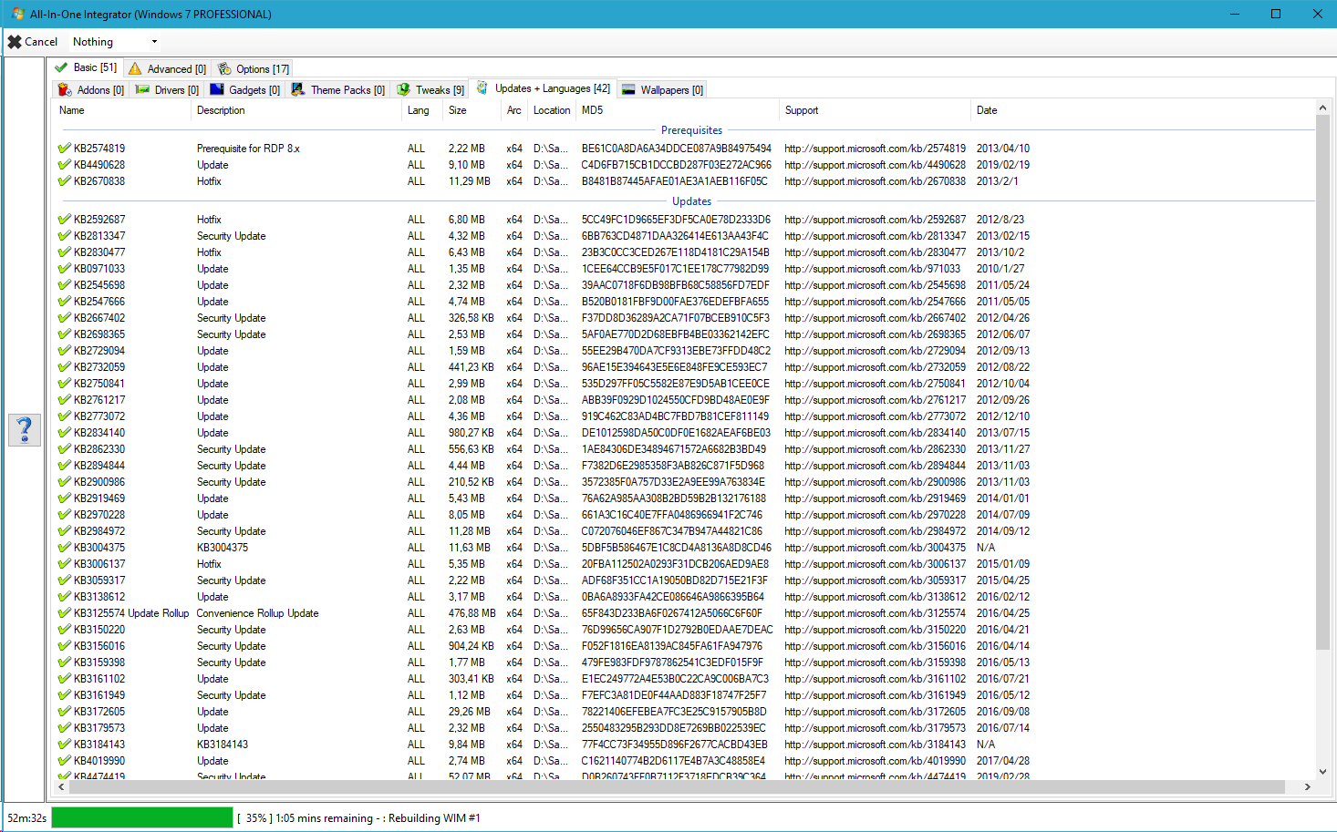

26 minutes ago, rhahgleuhargh said:
All is green in my case, I'm testing in x64.
I think I saw my mistake in your picture:
I removed KB3020369 from the pre-requisite and put KB4490628 in the silent-installers instead of KB3177467  🤬.....
And your observation and those from icare is confirmed, KB4490628 comes after the updates from patch-day.
Edited by Thiersee

5 hours ago, Thiersee said:
Just have a look to the picture from @rhahgleuhargh 😉!
Prerequisite: only 3 KBs, KB4490628 instead of KB3020369 (put KB4490628 manually in the prerequisite!).
Advanced-tab: 0, it means KB3177467 not necessary anymore!
