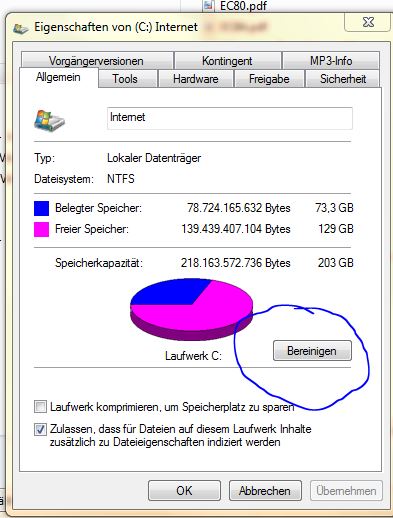

guys thanks again for this "wealth" of links, tools, info etc. unfortunately it comes with me asking some nubie questions. I try to figure things out first by reading what you guys are doing and the info you trade back and forth among yourselves. I made a new win 7 iso, experimenting, and tried using that deep clean msu you provided. while in my vm after the iso install I ran the deep clean msu and it said it was not for my version of windows. I am using win 7_64 and the _64 deep clean msu. is there a pre-requisite or something else I'm missing?
regards...
12 minutes ago, pennsylvaniaron said:
..... and tried using that deep clean msu you provided. while in my vm after the iso install I ran the deep clean msu and it said it was not for my version of windows. I am using win 7_64 and the _64 deep clean msu. is there a pre-requisite or something else I'm missing?
regards...
You don't need an extra-msu to do a deep clean!
Either you goes on Start, Search for "cleanmgr.exe" and start it or you go on "Computer", right-click on your System Drive (usually C:) and select "Properties", then click on the "Button" (I think in english is "Clean").
Thiersee
... and you'll find the log file in C:\Windows\Logs\CBS\Deep-clean.log.
Cleaned updates are usually at the end of the file. Just be carefull, KB2685811 and KB2685813 seem to be cleaned, but in fact they doesn't (only a part of them, so they still need to be integrated in your ISO).
And exactly this is the reason, because I do not integrate them, I install them later ;).
