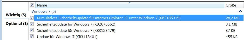

2 hours ago, rhahgleuhargh said:
@Thiersee
Strange, I didn't have this during my test this morning. But as usual, this WU bug will disappear in few days.
I think so too: I just installed the same VM with the last month ISO and they are requested too (not last month....).
