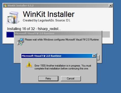

Everything working fine now, except for one thing.
My silent install for dotnetfx isn't working, the installation isn't silent and during the installation I get different errors.
After the other silent installs are finished and the pc booted into Windows I can run the installation with silent command from CMD without any problems.
How to fix this?

my silent instals are not silent when installing windows 7.
I for instance want to hava a silent installer of [slim] .NET Framework 4 Full x86/x64 with the /y switch.
However, during installation I still receive a pop up screen.
In previous versions of Winkit it worked, where can I download old versions?
If I'm using the same .Net framework as you, it asks me do I want to install the developer as well as client? TBH it was taking that long in VB to install I now just leave the file in the Apps folder, that way I can install when I need to. Not everybody needs .Net 4.
tsjippy, I don't have any problems with ricktendo's installer with the latest Win Toolkit 1.4.0.15. However, that installer must be made silent first with one of the swithces provided by ricktendo in his first post. Did you do that? I use the /ai with no problems, but I don't rely on Win Toolkit, I make it silent with this first.

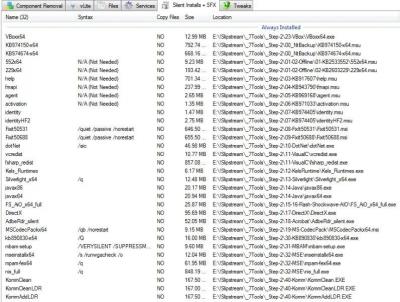

I finally got an AOI x86 + x64 that's working except that it doesn't pass the /aif switch to ricktendo64's DotNet installer. (All the other silent installs work fine.) Can I fix that without rebuilding the whole .wim image.
